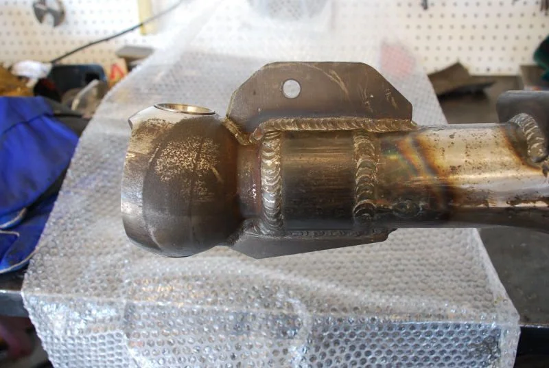

There's a guy on Pirate IIRC that is a weld on spacer that goes on the short side. You'd need custom made longs for the short side.
Is this what you're referring too? (Not sure if i'm allowed to site pics right from IH8Mudd, but regardless)
I don't like the idea of adding in spacers like that, i'd rather have one solid piece.

Nothing you can really do since the whole housing is just a top and bottom piece welded together to make the housing.
Best bet is to wait till Dan at Ruffstuff comes out with his housing, or go with a Diamond if you want all Toyota stuff.
